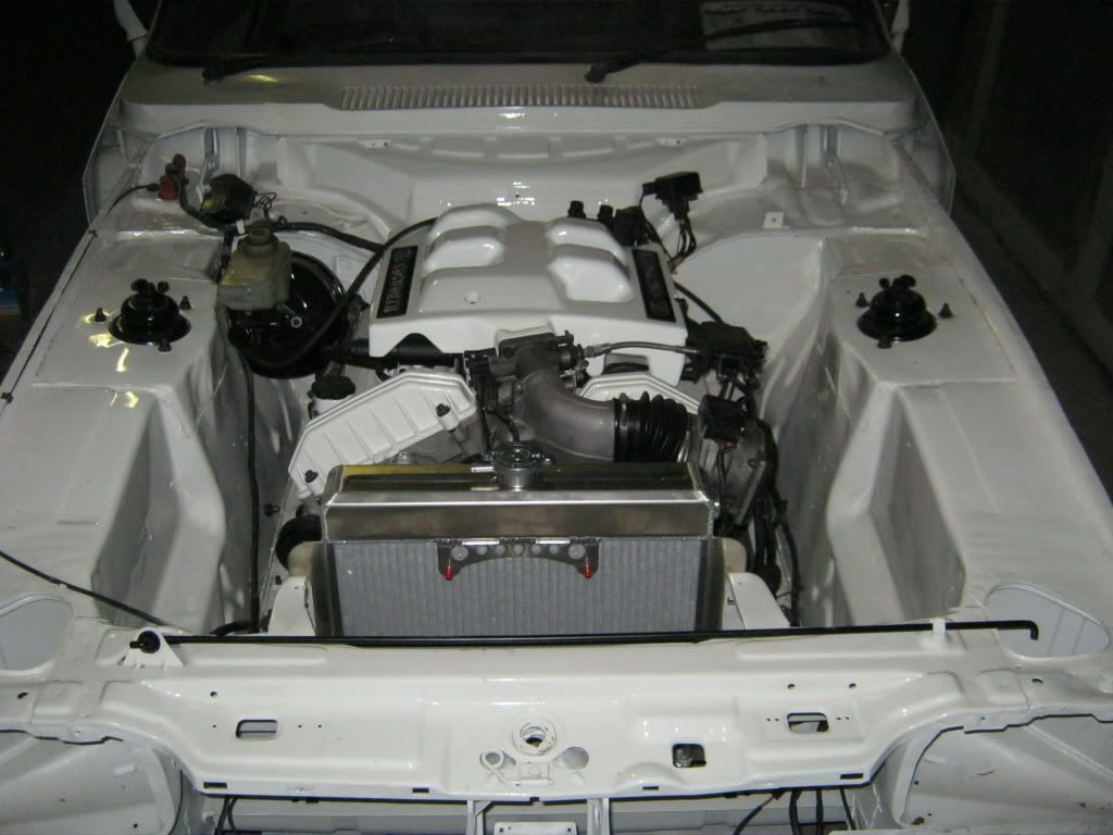

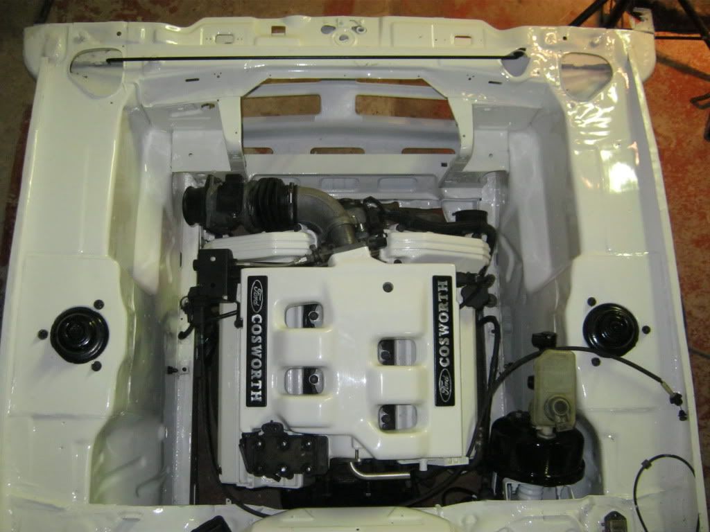

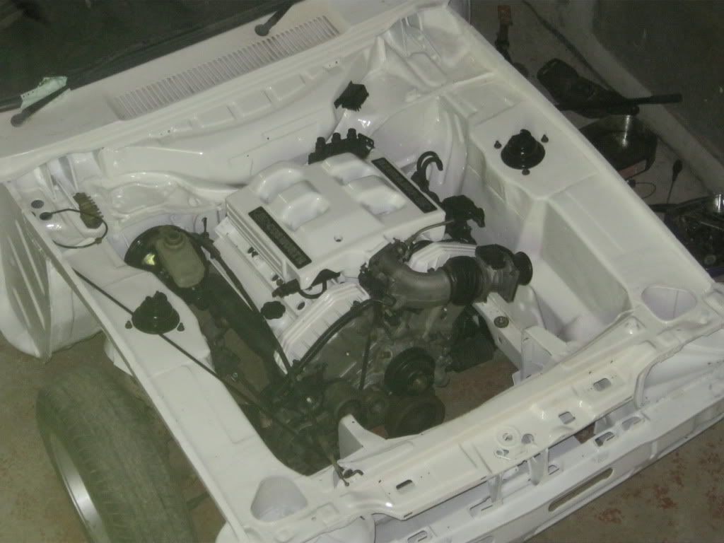

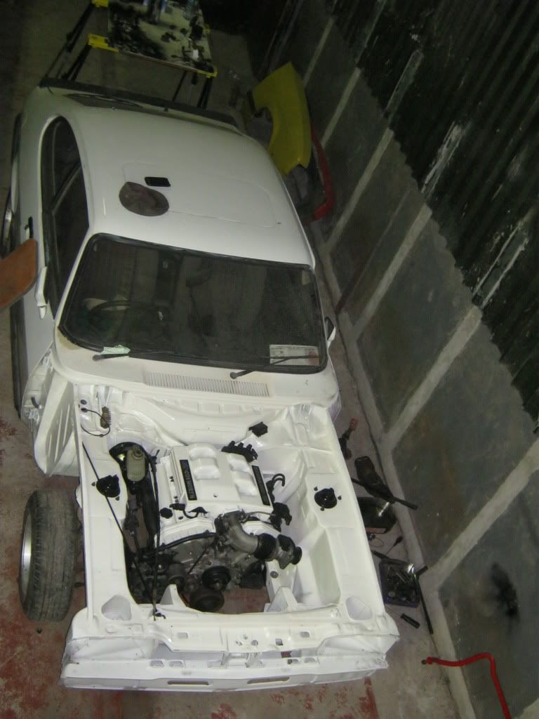

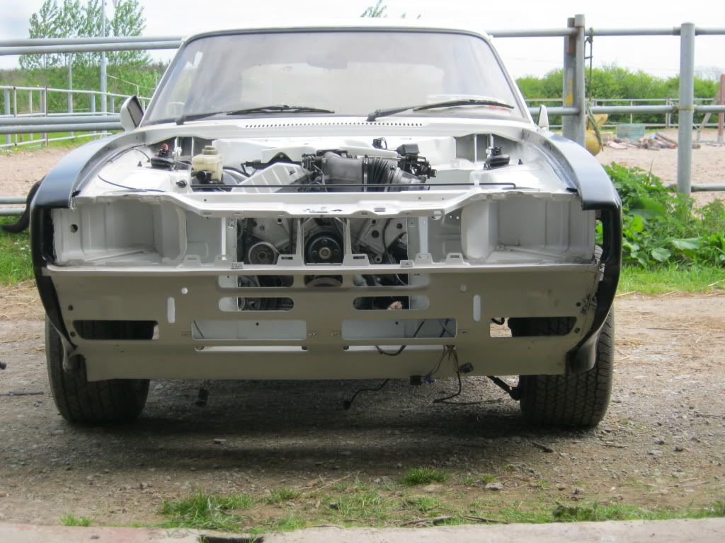

Hi lads,

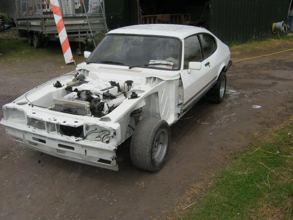

This is my 1.6 Mk3 capri which i am currently restoring and have fitted a BOA for a bit more power ;D

Looking good so far ;)

Nice Capri!!

looks very nice.

Looks mint mate ;)

looks lovely  ;D

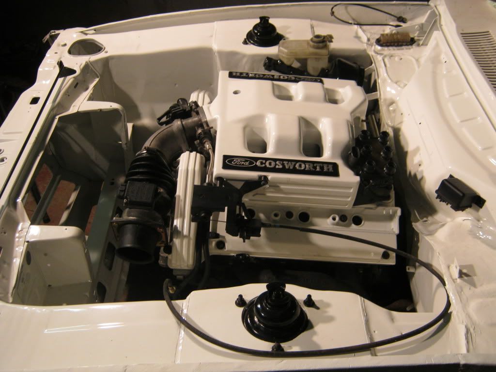

liking the white engine bits with the colour of the car, seems to go very well with white  :ph34r:

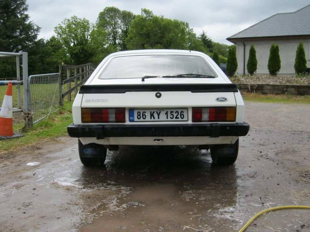

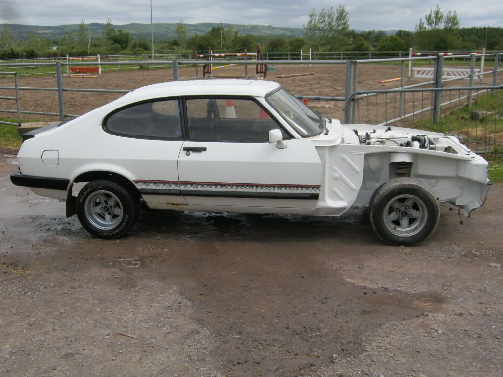

« Reply #6 on: April 25, 2011, 20:24:13 PM »

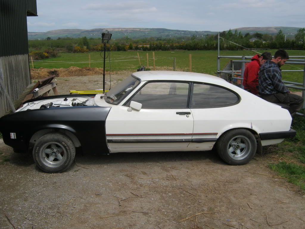

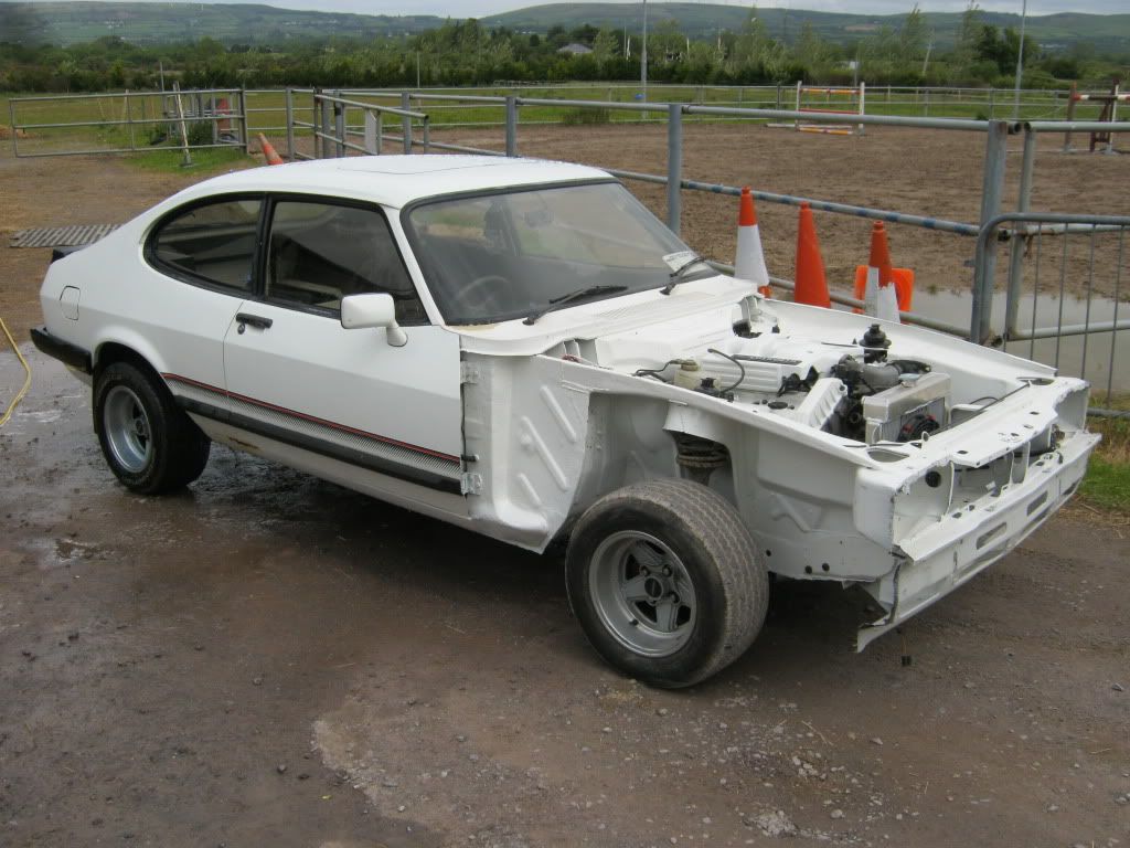

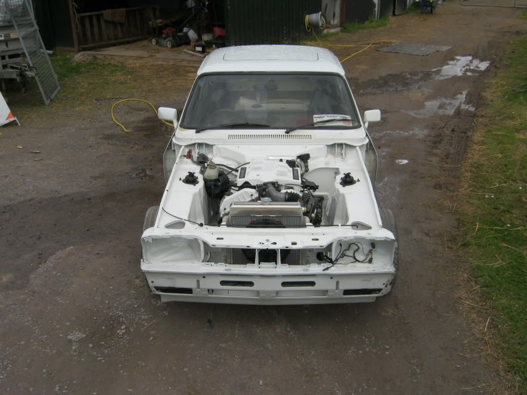

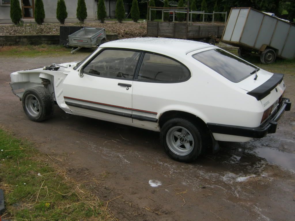

few more pics of my new wings and compomotive wheels

Class paint job on the engine....

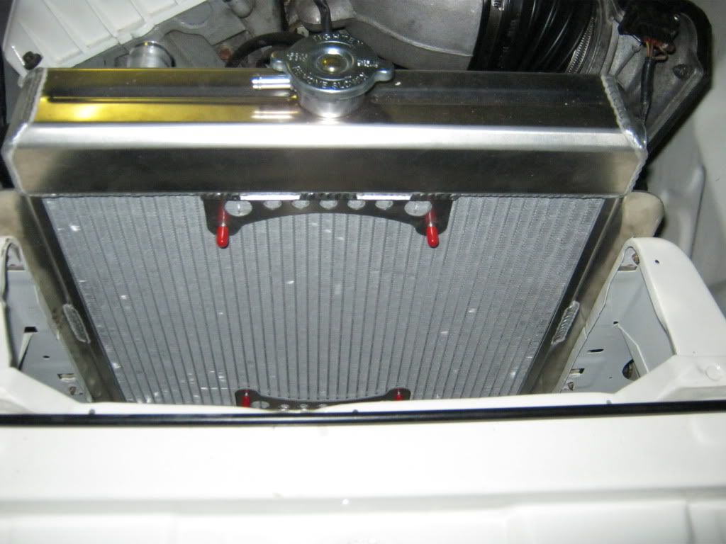

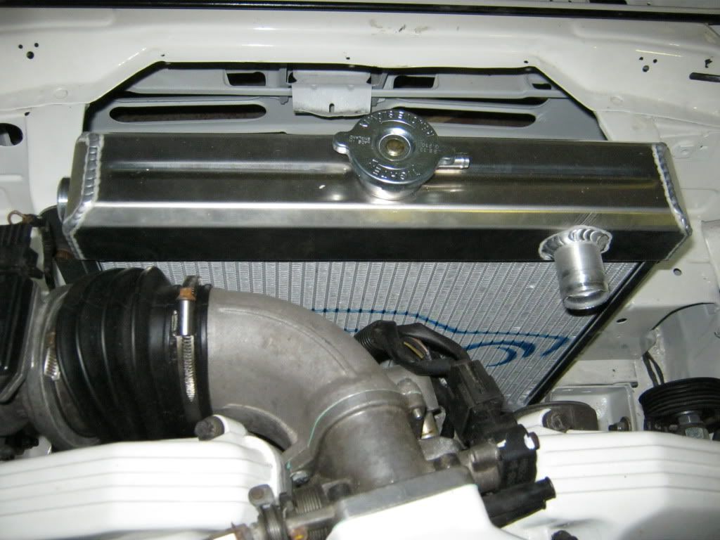

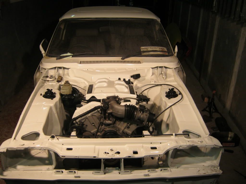

Few pics of the rad that GRP4 Fabrication made for me.

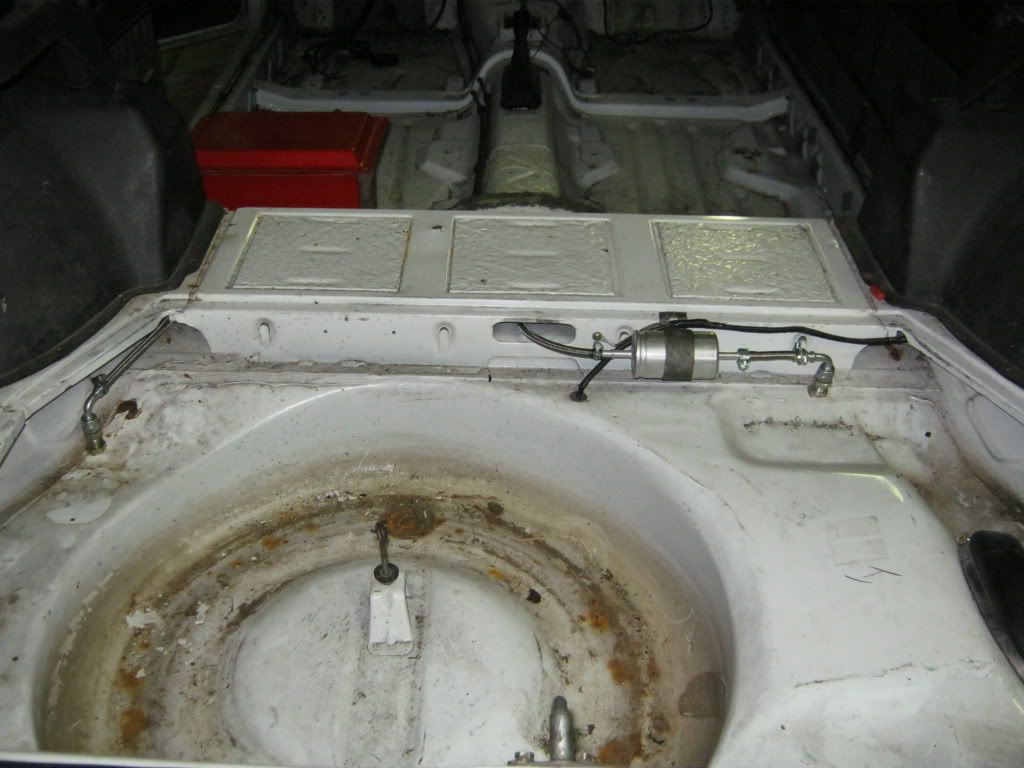

« Reply #11 on: May 22, 2011, 21:09:19 PM »

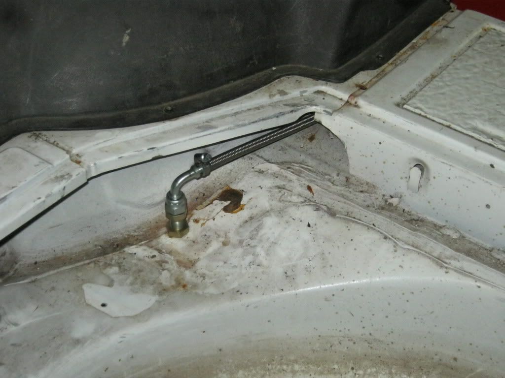

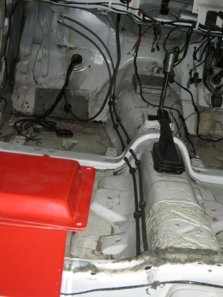

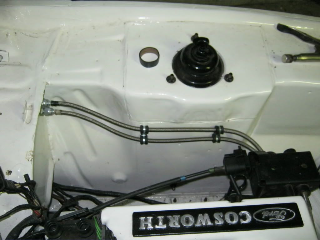

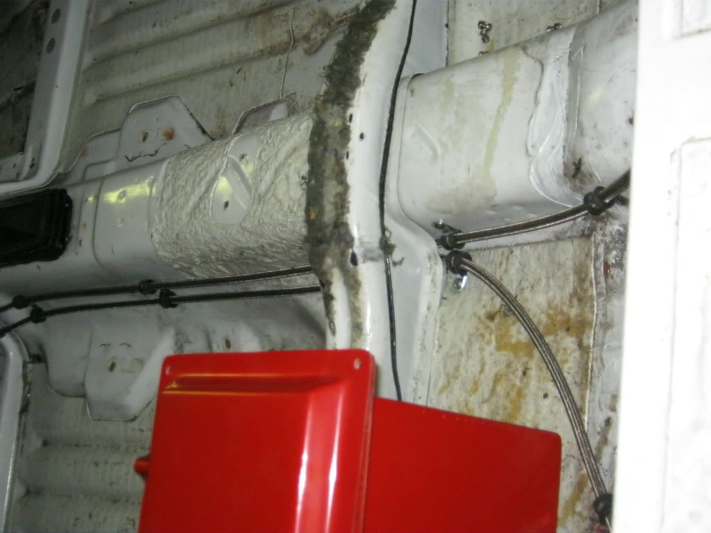

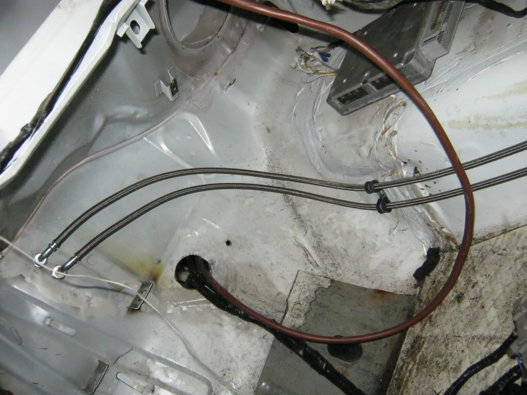

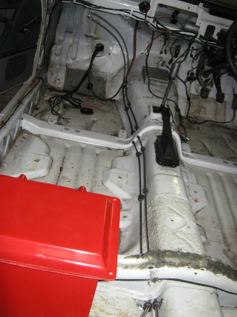

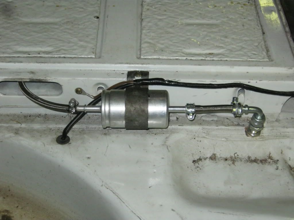

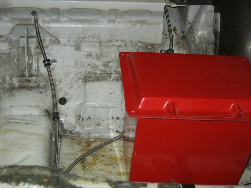

Pics of fuel system
fordpinto
Re: Mk3 Capri BOA
« Reply #12 on: May 27, 2011, 22:50:14 PM »
  • Posts: 6831
Re: Mk3 Capri BOA

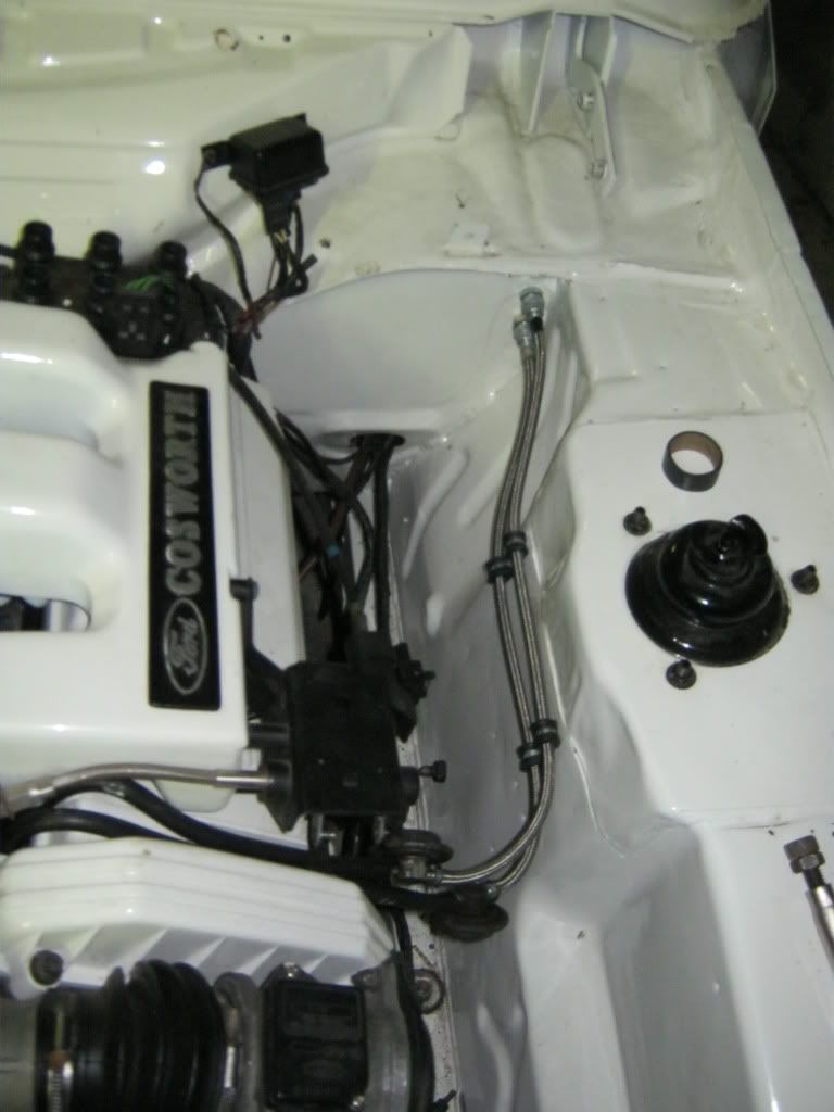

« Reply #13 on: May 28, 2011, 08:27:12 AM »
2 safety points.
you have nice steel braided fuel lines ;D with normal hose clamps :'(
i would take the braided fuel lines out off the car and have the connections pressed on instead off hose clamps.
hose clamps are not designed for 5 bar working pressure and they are not designed for braided fuel lines but for rubber lines.
and running them inside the car is not a good idea either in case off a leak.
fordpinto
Re: Mk3 Capri BOA
« Reply #14 on: May 28, 2011, 12:01:27 PM »
2 safety points.
Thanks for the safety points V8. But dont worry the hose clips were just on there to keep it all together while i was mocking it up. It is all sleeved and crimped now. So i dont think i should have any issues with leaks. Ilkeep a few fire extinguishers in the car just in case  ;D

Looking so clean under the bonnet mate  ;D nice rad too and you gotta love braided hoses  :mellow: I do.

« Reply #16 on: May 28, 2011, 20:32:06 PM »
l keep a few fire extinguishers in the car just in case  ;D
those little fire extinghers are no match for a fuel fire in a car.
i already did the testing for you :-[ :-[ :-[ ;D ;D

crimped eh? hmmmmm ;)
