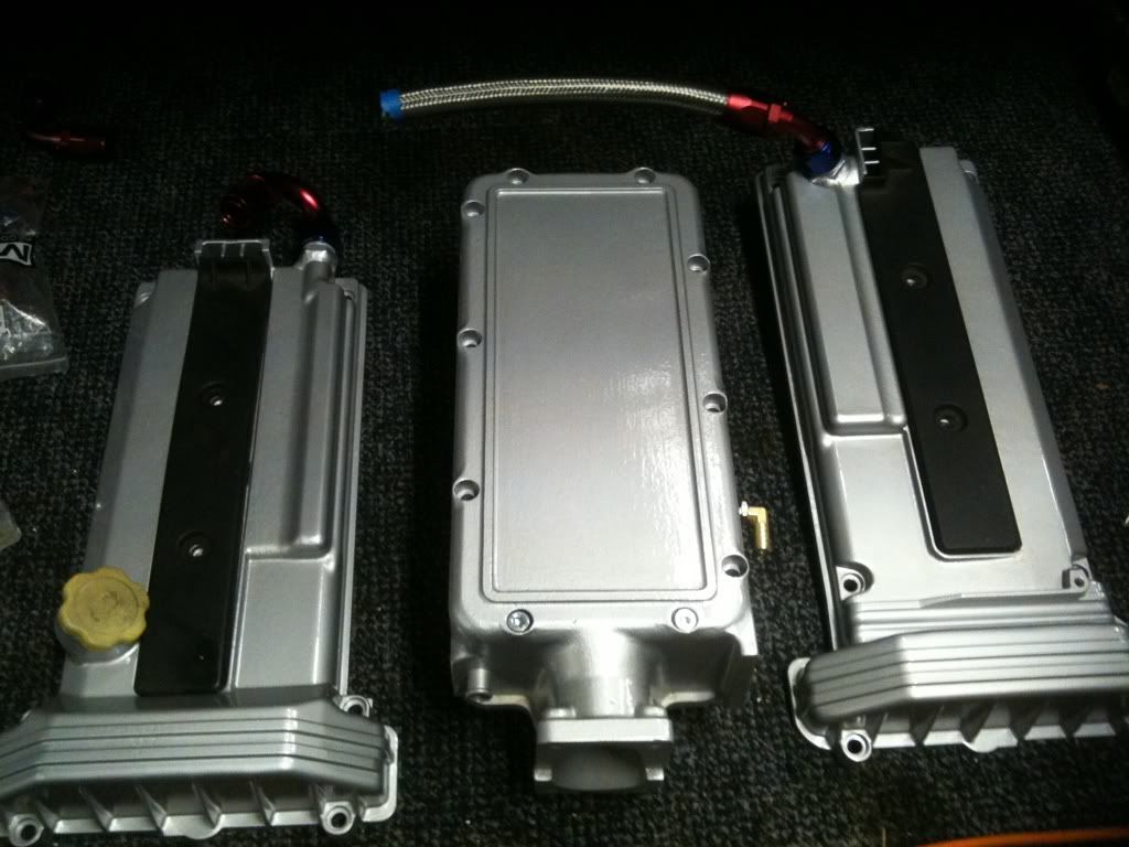

As above I have had a dash12 welded to each cover in the original locations and a dash8 return to the sump.
After welding one of the splash guards has come out  :rolleyes: I will be having a custom separator and breather from bailey or spec r later on so should I replace it or not and with ? rivets or what, as ford only dressed a small head of the alloy cover over them  :'( The yb they drill the cam cover and let the separator sort out oil back to the sump. So repair or ditch ???
Cheers Ade

using a breader and a catch can is something i would do.
you could use rivets to hold the splash guards or little screws with some lock tight.

I would refit the splash guard as it makes life easier for the oil separator.
The crank case breathing of a turbo engine is very important, you want it to work the best it can.
Puffs of smoke on YB's etc is not usally worn turbo's but poor breathing systems.

Ok guys back in it goes  ;D The breather on this won't be working as hard as a 500hp yb will it ? Some of them Yb its black too, bad mapping on big injectors ?
Cheers Ade
Done and on ;D

When I had my covers powdercoated I removed the splash plates and refitted them with M5 bolts and Loctite.
Just make sure the camlobes don't hit them.
I used flathead Allen bolts.
