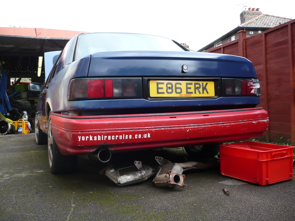

The only things I had to do was replace 2 front drive shaft gaters and sort out the exhaust. The pipe to the back box had broken and needed a proper bodge to reconnect it for the MOT.
Peco box was not my choice - it was already on the car when I got it.
I am saving for a full stainless system so do not want to be buying new sections for this one as the whole thing is about ready to drop off. Amazingly it passed with only an advisory on some minor leaks. The only other thing noted was that the break pipes will need attention for the next MOT. I have borrowed a flaring kit to make up some new ones this summer.
