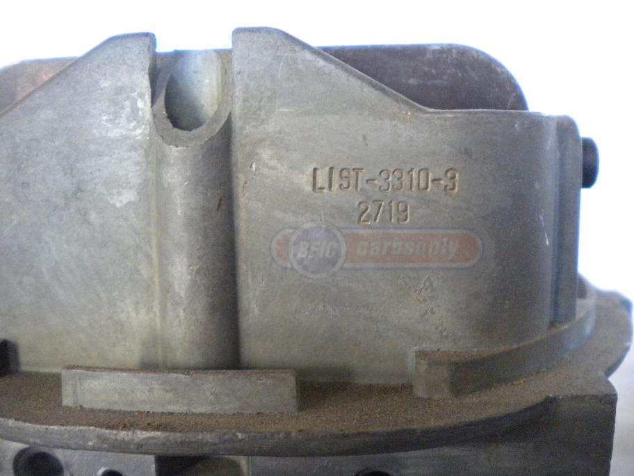

There should be a list number on the carb.
Like this.
Do you have a picture of the carb?

That's a elcheapo 600 cmf 4160 type holley replacement carb.
It runs nice on a stock small block, but it has no place on your engine and its hard to tune without poring money into.
