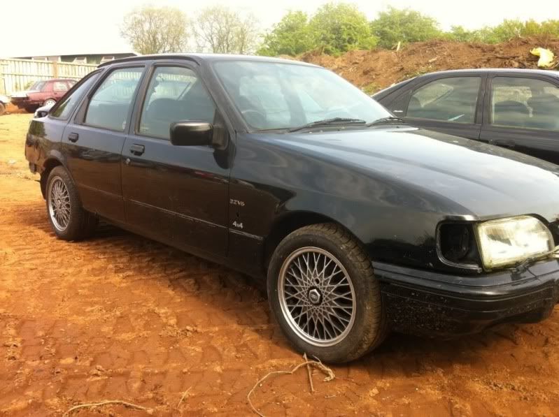

Bit of a long shot but does anyone know this car? Black sierra hatch J335 YNO
It was apparently built by top boss performance
The engine spec is supposed to be
Engine; 24v BOB
bored out to 3000cc (can 3.0 pistons even be got for these)
mahle pistons (are these not what’s in them as standard)
3 branch s/s manifolds (i'll add a pic of these)
custom ecu wiring
full s/s mongoose 2wd exhaust system
fully rebuilt, all new gaskets (hmmm)
pipercross induction kit
mocal oil filter relocated (where is best place to get these)
bob cams
upgraded injectors (unknown what these are from) maybe the Vectra ones?
chipped ecu (is the chip for these a piggy back or is it internal chip? its a BOA ecu
Anyway reason I ask is I have the engine from this car, so I’m not concerned about the car
I’d like to find out what I can about the engine.
hopefully someone will recognise the car and the pics of the engine in it.
also the gear box has been painted red.
here is a link to the last person who had it with plenty of pics of his build.
http://passionford.com/forum/restorations-rebuilds-and-projects/380839-24v-sierra-4x4-update-new-wheels-fitted-4-9-11-a.html
