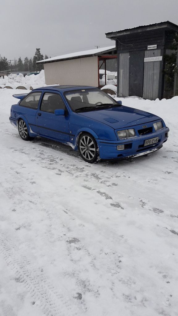

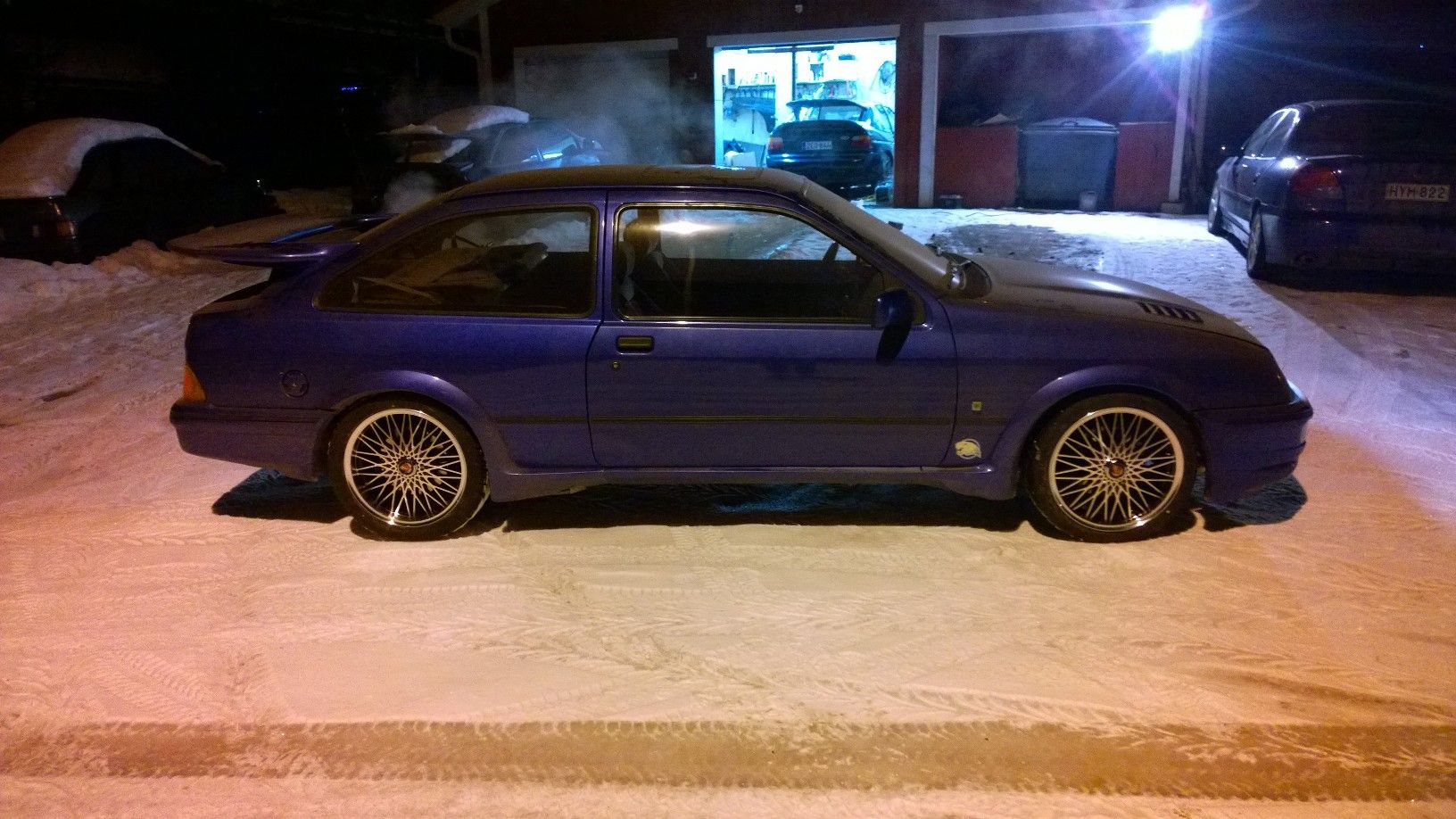

Winter pic and new wheels.  :mellow:

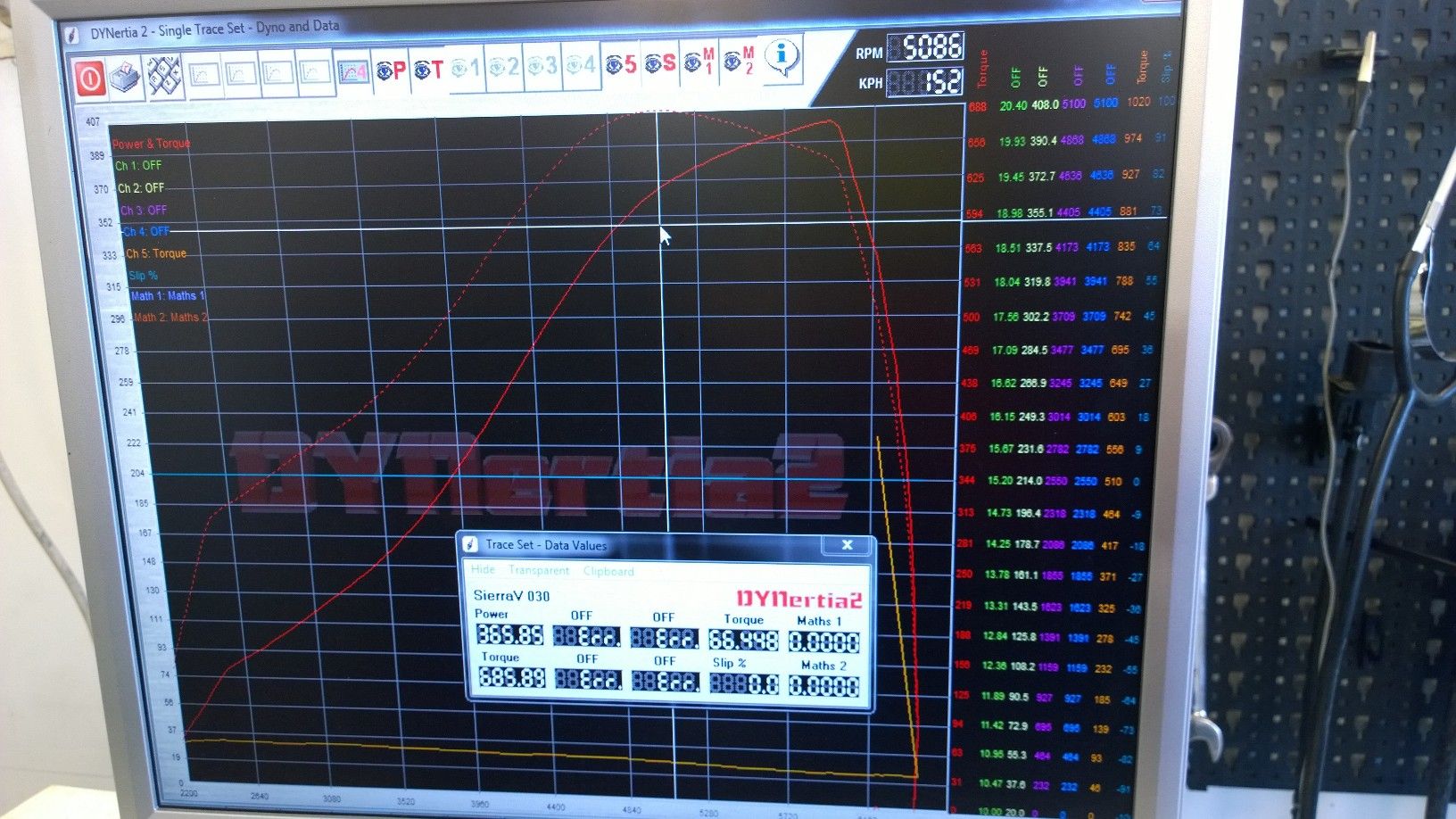

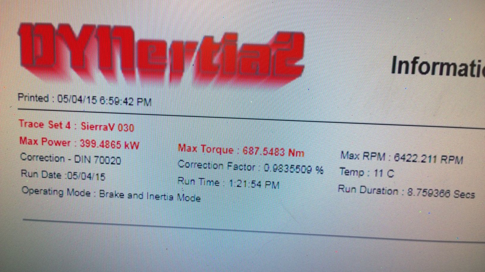

This is wheel Power. Re85 fuel and 1.0bar boost.

very good results from a stock 3.5.  ;D
Re: Hello from Finland!
« Reply #193 on: April 13, 2015, 22:21:18 PM »
Very good Pete.
It's doing exactly what it should do.
I think STD they are about 260bhp & 250 lbs/ft.
1 bar doubles it unless there is a problem.
So 535bhp & 506 lbs/ft at the wheels is fantastic! :2tu:

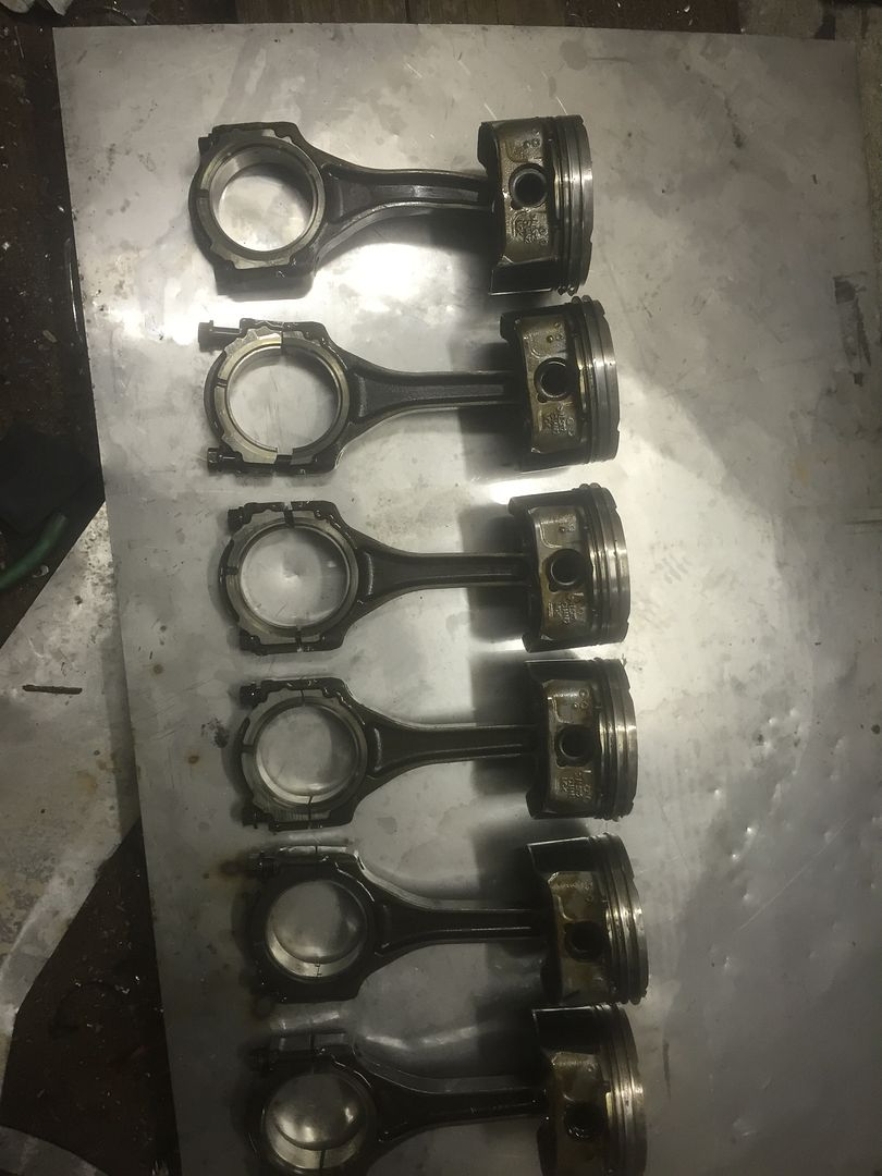

I order h-beam rods and JE forged pistons. Old rods stories the end.
About 1.3bar /7200rpm

Ouch !!  :o
Too much cylinder pressure ?
Matt
Offline mk2 cossie
  • Posts: 614
  • Linux Linux
  • Chrome 43.0.2357.93 Chrome 43.0.2357.93
« Reply #196 on: June 18, 2015, 18:42:20 PM »
At least we know what standard duratec v6 rods can stand up to  ;D
1.3bar and 7200rpm is quite good going  :o

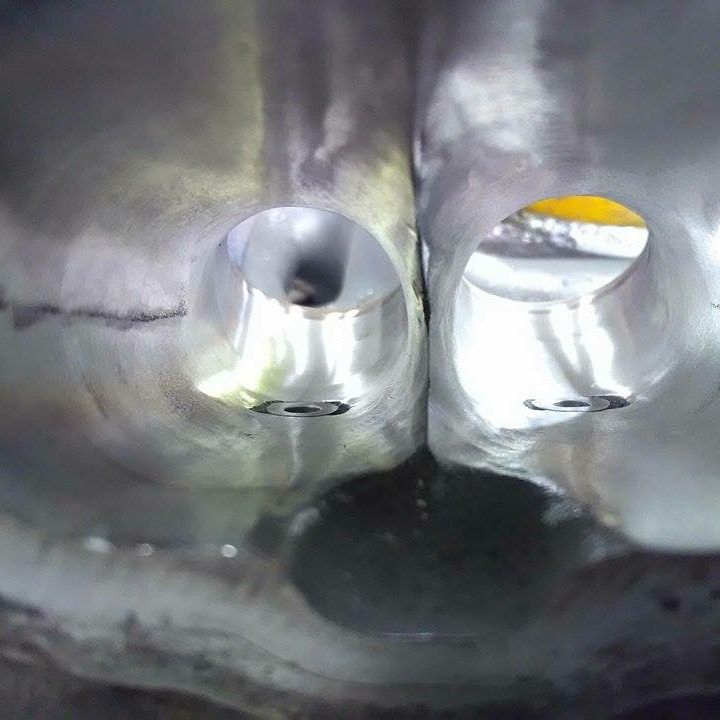

New yeards and new games.
Now we ported heads and look this.
Maybe better or not. :)

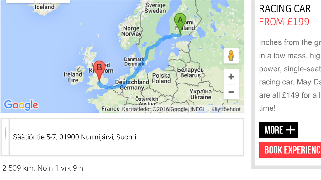

If all thinking a possibly we visiter (again) next summer a Ford Fair days this car. Let's see.
Travel About 2500km
